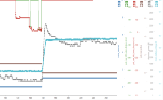

Here's some CAN internals from a moment of connecting a trailer while engine is running and PDC active
  • PDC left inner sensor (red) sees the trailer at under 1m distance first
  • Both the left outer and inner (red, green) see me coming to connect the trailer, distance goes near 0
  • Trailer connected (blue)
  • Rear PDC is deactivated automatically when the trailer is connected (brown). Interestingly, the sensor distances are reset also at that point - I would have thought they keep reporting the distance but are just ignored.
  • Voltage at main battery jumps to 14.7V (cyan)
  • Alternator power production jumps from 500W to >2kW first but stabilises to around 1700W (grey)
  • Strangely, today the voltage was little bit higher first but later in the drive it went again to 14.4V
  • There's absolutely no way my simple trailer with just couple of lights and no battery would eat over 1kW so the van does this as a part of charging program when trailer is connected
One more interesting tidbit: alternator DFM signal reacts to the power increase but returns to (almost) it's levels before power production increase. Not quite sure about this one but as the DFM is the "load signal", I think this might be an indication of the power production increase to be commanded rather than load based.
