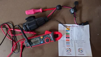

This is my experimental 13 pin plug. There are 4 grain of wheat 12v lamps connected to the 2 sidelight and 2 indicator circuits as that's the circuits used for trailer detection. Also there is a CTEK charger connector to test the battery lines.
Trailer detection
Shortly after plugging in the grain of wheat lamps flash in sequence. This happens.even if the van is locked.

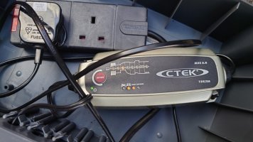

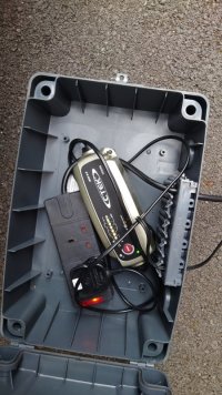

Well 10 hours later we are charged.
I was going to have the van out tomorrow but may take the XC70 and see how long it will stay in this state. For science :geek:
So at the about the 36 hour mark since I locked up and still live. Taking photos mostly for the timestamps.
Of course I want to do some tinkering in the van for the Bank Holiday but also don't want to disrupt the experiment...
Now at the 3 day mark since locking and trailer ECU still awake and full lights on the CTEK. It hasn't dropped into the final maintenance stage yet.
Clearly enough for the 12v EHU use case, I want to keep pushing a bit longer for the maintenance use case, probably will run out of patience at the 5 day mark :sleep:
Right tonight has to be endex as I need the van tomorrow. CTEK was still happily charging after 5 days and 9 hours.

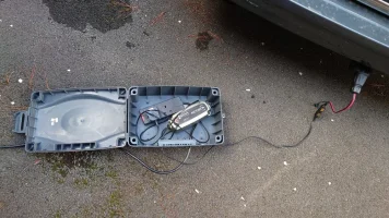

If you're a T6.1 like me then you will have the handy additional plate fuse box on top of the battery, so dead easy to fit a quick connect between that and the wing ground bolt.
Then if you get a quick connect extension that will easily fit through the closed bonnet seal to a waterproof box with charger and give you almost the same solution.

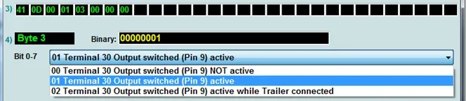

I would expect the functionality can be coded similarly to T6 (below, always active).
Interesting...
I'm trying to avoid the temptation of VCDS and keep things "stock" till the end of the initial warranty but this and a couple of other things are tempting.
What I'd be most interested in is if this could be done on the switched live Pin 10, because then I have an underseat ignition switched 30amp feed...
