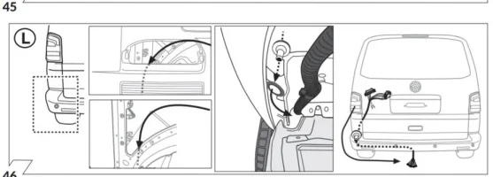

As you have the trailer prep, the PFJones instructions will tell you how to connect. Very straightforward. Remember to slide the rear light clusters sideways off the van after you’ve undone the screws. (Otherwise they are a pricey replacement if you break the lugs in them!)
So all the wire colours will match on the PF Jones and VW harness? Also, the PF Jones instructions don't say to remove the tail light. The harness is routed from the connections inside the rear left panel and down through some grommets to get behind the rear bumper.Capture 1.JPG
