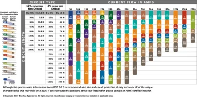

Any advice on how wire diameter is decided appreciated. I have read before that over specing of the cable can approve efficiently which I’m also willing to consider doing if it seems worth it.
Have a look for dc cable size charts on google, will look something like this
DC_wire_selection_chartlg.jpg http://assets.bluesea.com/files/resources/newsletter/images/DC_wire_selection_chartlg.jpg
Then it’s just a case of working out what current and length and finding the recommended wire gauge for that application .

I used the 16mm2 cable for +/- starter battery to redarc and leisure battery to redarc (with 50A / 100A midi fuses as intermediate connection points) also for leisure battery to chassis ground cable and leisure battery to inverter ( under driver seat)
I made up a ‘hydra’ cable out of 10 x 14awg wires that feed a 10 way fuse box (via a 30A midi fuse and a 50A cut off switch so I can isolate the fuse box to turn everything off in one go)
I used the 14awg cable for diesel heater (15A) feed wire (via a relay so I can isolate the heater to avoid current drain when I don’t need it)
Everything else uses 17awg wire (led lights/usb sockets) as they are all under 6A feeds.
I have yet to add cables for a fridge, but that will be of a suitable size for current and length as well.
