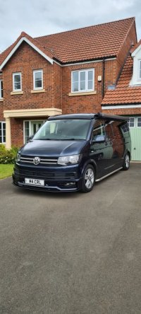

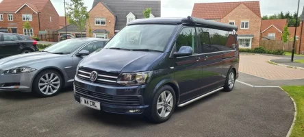

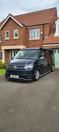

Had my Starlight since March last year. 12 months going full on camper, i've just spent the best money yet and had an ST-X suspension upgrade. Completely different vehicle. 100% improvement to the ride.
Sportline bumper and lower splitter due this week.
Hi my fellow Starlight Blue person - can you do a side on picture please? What wheels and tyres do you have on ? This is my next rabbit hole. Many thanks.
I know - I only looked at the email : there is a lovely side view above. Oh hum.
Can I ask wheel size/fitment and springs? That is sat perfectly!
