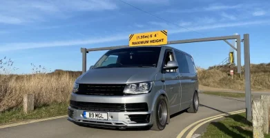

Here they were on my T5...
The 8.5 on the front is slightly tucked inside the arch and the 9.5 on the back is pretty much level with the arch lip.

Hi @huw169 I’m not running the banded GP’s anymore (sorry @Trouts ;)), but I’ll put up a couple of pictures that are probably on this thread already if you look back.
Anyway, I had 9” on the fronts and 9.5” on the rears with 235/55/17 tyres all round and no rubbing issues whatsoever and my van is lowered by approximately 80mm. A note on the rears rubbing the sliding door cards…. previous to the GP’s I was running banded Amarok’s…. again with 9.5” rears and these ‘poked’ out more than the GP’s. With the Amarok’s I had a slight rubbing on the door card, but definitely not with the GP’s.
