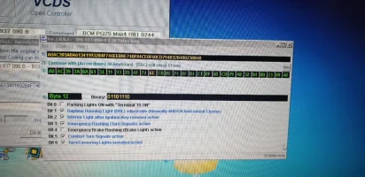

I bought full set of LEDs from Pauly including self levelling and wiring looms. Fitted all and codded initially as per Roberts instruction here but have found that lights were suddenly (without driving) turning themselves off. Changed byte 18 from 73 to 67 as someone was suggesting here and so far that's best I could get. All seems to be working "pretty fine" apart of few things; while driving from time to time either left or right light is flickering, extra menu for lights&vision didn't show up, when I put high beam on error on dash comes out. Final less important thing leaving home is activated but coming home even is ticked activated doesn't work.
I would really appreciate if someone could have a look of the below and point out what might be wrong in the coding.

Do you get BOTH dipped AND high beam on. Or just either or? The coding in byte 22 ("2C"), suggests that the both are not on, which probably would cause the dash error. To start I would propose try to change byte 22 "2C" to "28" (just clearing the bit 2 see --> Bcu Central Electrics Module 09 Byte Screen Shots ).

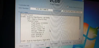

And please check the fault codes - there should be some as you got the dash error.
I have seen similar fault codes on LED conversion, think it will normally say 'open or short to positive' followed by high beam left or low beam right etc, error numbers normally in the 30s

Hmmm.... the first picture (yesterday) was obviously from a different vehicle. So the coding for byte 18 in this one is definitely "73".
Is someone trying to test our expertise:sneaky:?

Hi guys,
I just realised that the photo I have uploaded two days ago is the screenshot I took (of someone else) and not my actual coding ‍♂️♂️SORRY! That explains confusion about different vehicles.
Please find photo of my codes below.

In the picture the byte 18 is "CE" - is this coding before retrofit as I would expect to see "73" there? The byte 22 is "79" - what I expected it to be when having both dipped and high beam on.

Thank you for the tips @mmi @Robert . Lights stopped flickering and warning on the dash is gone!!
I've changed byte 16 to D0 (had to tick bit 4,6 and 7 as with 4&7 lights still been flickering)
Byte 18 I had previously on 67 (as someone was suggesting) but that was changed to 73
