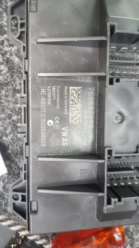

No. Mines a 2016, but it's a euro 6. The euro 6 engine appeared much earlier in the people carriers, than it did in Kombis and PVs. In fact I don't think there was a euro 5 T6 Shuttle. Existing factory BCM took the cruise without issue. I wanted cruise on the stalk as I didn't, at that time have a MFSW and actually preferred it in this location. I've just retro fitted factory fog lights too. No issue there either. Just plugged straight into the original BCM connector. Here's my BCM if this helps
The part number combinations have a 'Colour code' Which is a variant of that part number not listed on the part or VCDS usually.
For instance the one listed for @record1976 's 2017 Shuttle in standard form is 7E0 937 090B ZDV. The ZDV part is the colour code which states 'without cruise or fog lamps'. There are 270 versions of the 7E0 937 090B which are differentiated by colour codes. There are 55 different sections of ETKA for the BCM, each with a slightly different date range or base spec and each potentially with hundreds of colour code variants inside!
Without counting, there could be thousands of BCM variants, It truly is a retrofitters nightmare!

Well b****** me! This may finally be the answer to the very first T6 issue I had, why I couldn't get retrofitted Safelock coding to work on mine, even though it was fitted with a BCM with the same number as all the ones that did have it.
Ah. Afraid I'll have to pass then as I've no knowledge with this bit. Maybe I was just lucky with the BCM I had fitted in mine from the factory, as it took the cruise and fog/cornering light wiring without issue.
Just giving this some thought. @zebra quoted this in his very useful fog light retrofit post.
Depending on the set up, you may need a power source which will go to position 11 on the block and be routed to a steady positive connection in the fuse box (SC12 in the VW wiring diagram). Mine already had this in place so wasn’t needed.
This is the power supply wire into the BCM that the fog lights use. Like @zebra mine was already on situ. Would establishing if this wire is already in place help you in working out if the BCM can actually do something that's not listed against it. ie cruise and fog lights. Just an idea.
