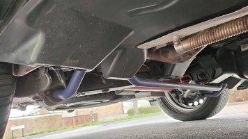

As per the title, WTF is this for on the underside of our T6.1 please? it is a small piece of plastic on the underside in front of both wheels that drops down slightly. it’s like a small mud flap if that makes sense.
the picture I have is poor as the supplier has hacksawed through them. i am just wondering what they are and what they are for. let’s just say I am not impressed and they are telling me that they serve no purpose. if that was the case then why would Vw spend the extra money making a more complex part.
small wind deflector
OK, I was wrong then as thought it might be to divert underbody water flow down and away from the brakes.
What are the consequences of not having these on the van please?
It looks like they have removed the splash guards for the suspension bush mounts.
The only reason I can see for that would be to enable access for jacking the van up or applying axle stands for support.
It is difficult to find anywhere to put axle stands on the rear with all the covers on because the place you jack it up is where you want the stand to be, there's not many points that are suitable for axle stands on the back end.
If they have sawn them off to do that then that's just laziness, I'd be asking for replacements.
If they served no purpose then VW wouldn't have put them there. They don't spend money on parts that are not necessary.
They should look like this..

Since it’s the same part but extended to fill between the fuel tank, is the bulk of this (With the X) also a wind deflector and is it covering anything? I noticed it in schematics for the LWB and it’s not there for the SWB as this is where the chassis extension is.
The underbody plastics are there to protect the underside of the chassis/body from road dirt/salt/water etc, they do a pretty good job of keeping the chassis clean and rust free.
Take any of them away and rust can set in quite quickly once stone chips get through the paint and the salt water follows through.
I guess on the LWB that final cover just fills in the extra 12" space that's there behind the tank, you can see the back of the tank on my picture at 3 O'Clock.

The photo in post #9 is a LWB
The T6 didn't have them were they wrap around the jacking point, so you could remove the under tray on a two post ramp easier.
