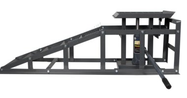

I just use a pair of heavy duty ramps - no messing about with balancing the van on jacks/axle stands/orange boxes etc. Far safer. I bought the ramps with hydraulic lifts combined in the top of the ramps but have never needed the extra lift that they provide. If I can get under with my arthritic body I am sure the younger fitter members would have no problems.
Of course only good for the jobs like fitting heaters when you aren't taking the wheels off.
So you have a link for these @oldiebut goodie ? I am intrigued as my van is parked on a hill hence these may make my life a whole lot easier?
