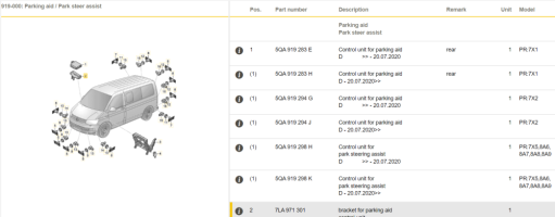

You will need to replace the control unit with the appropriate one, they are normally labelled parkhilfe 4k or 8k or 12k and that number represents the amount of sensors fitted to the vehicle rear only = 4 front and rear = 8 and full park assist = 12

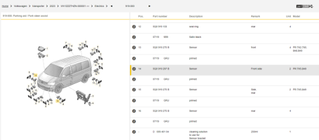

@Pauly would you happen to know the part number for the 2 side pla front and rear sensors please? I’ve got the 298 module in and extra wiring for the four sensors but having trouble finding the correct side sensors. Many thanks in advance

I've just got rear sensors at the moment, so if Im understanding correctly, i just need to pick up an oem front bumper loom inc sensors and an 8k module? Is there anything else? Do I need to run a new loom from the dash to bumper or does it just plug in somewhere?
Much appreciated!!
You also need the additional speaker, the dash button and wiring for those two components
There’s is two parts to the front sensor wiring, there’s the bumper loom then there’s the wiring from the module to the bumper
IMO it’s much easier and cheaper to buy a kit like the ones linked above
