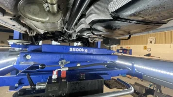

I lowered mine about this much. I hired a ramp which had an integral jack, so it was very easy to raise and lower the tank at the flick of a switch ( previously on my T5 I did it at the kerbside with the T5 jack and some wood!).

However lying on the floor staring at it and contemplating my options I realised there is an inline connector in the aux heater line at the back of the tank that is completely accessible with the tank in place. So problem solved and just ordered a quick connect Tee on eBay.

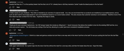

About the return valve, I watched this video
In the comments the Eber people seem to say you can use the retrun fuel line?

The Eberspacher people are wrong - it has been proved that there is a non-return valve in the return side in the van pump. All that they are doing is using the fuel from the engine side and with extended use this will be exhausted as has been proved previously.
