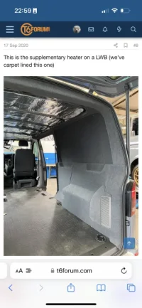

I’m not ditching the step water tank - it’s plumbed as one with the other half behind the b pillar. I’ve invested a LOT into that installation. :-/Could you get a duct behind the rear wheel? There is a void down there that might work, though I think you would have to go in via the sill.
Alternatively, sacrifice the step water tank and put the heater there. You could put a corner water tank back left, as you only need a skinny pipe for water

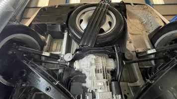

Have you got any more photos of all the plastic covers underneath. I need to put them all back on like a puzzle
I did a video under the van so I could record how to put it all back before I did the heater and water tank. 4Motion LWB.Have you got any more photos of all the plastic covers underneath. I need to put them all back on like a puzzle![]()
Legend thank you!I did a video under the van so I could record how to put it all back before I did the heater and water tank. 4Motion LWB.
Oh wow, thanks for your help - I didn't realise I wasn't tracking replies to this thread / forum - I am still too busy with house repairs to look under our van but it's on the list...
I guess you can’t get the exhaust past the differential. It has vestigial heat shields out to the back. I’ve no idea what a FWD LWB exhaust looks like- maybe it’s the same.Hey @drinfinity how come your exhaust doesn't go out to the back bumper?
That plastic cover on the left rear corner is bizarre. I really hope I can fit a heater in there but that's still a fair way down my task list...
