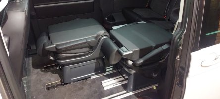

Okay, I tried putting a single seat centrally (thanks for the idea! @caravelle_hopeful)
The rail system does fit but it is very tight for legroom in my SWB - not really workable for the back row, and you have to sit a bit sideways on the outer singles. 20231107_193812.jpg
That's with the central one as far forward as it can be.
Ignore the table - I didn't bother removing it for the test.
Hope that helps!!

Yes very helpful to know it works in a pinch!
How about putting the single between the bench and the two fronts? possible legroom issues for the singles I guess against the front seats
It doesn't make much difference which configuration you use, you'll have legroom issues on more than one seat in a SWB. I'd be interested to know how much more room there is in a LWB.
40cm
Switched the seats around for proof of concept:
9 seater here
8 seater here
There’s enough space for 4 rows in 9 seater mode with adult-ish legroom in each row, and with 8 seats (2, 1, 2, 3 configuration) you can get a decent sized boot as well at the cost of quite narrow legroom.
