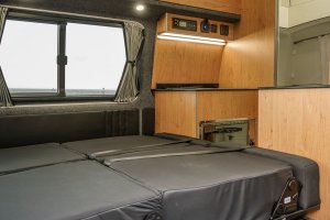

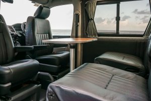

Here is mine. ( All done by the converter)
From this:
to this
Thanks for that. Yes, I have seen that layout and if we decide to go "full camper", would be going for this layout. Autohaus I know do a Camelot with this layout. Do you find those bed comfy/do you use a mattress/mattress topper on them?
What we are trying to do at the moment is use the seating we have to just use for the odd night here and there (Like T6 forum get togethers!). We have a motorhome for full on camping trips.
Thanks for your input.
Mine is a Camelot Grandi - LWB, built to my specs. The beauty of the seats is that you are sleeping on the backs of the seat and backrest not the surfaces that are in normal use so they are completely different to sleeping on most seats that don't flip upside down.
