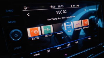

Just been out to the van to double check and this is what I see.
I know Radio 2 gets good DAB and FM here so this is what I see with DAB enabled (see note after station name)
And this is what I see without DAB enabled (no note after station name)
The station is the same preset in each case.
Note that even with DAB disabled the source button bottom left still says "FM/DAB" which is confusing...
On my unit the DAB option is under radio settings (the little gear icon bottom right on the radio screen, not the main settings menu) then "Advanced Settings" and here:
I think the mid range and top end units are fairly similar menu wise.
