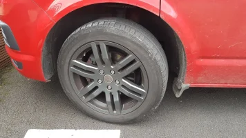

Love Sportline2's .... like the anthracite but too similar to the van colour so opted for silver . Now just got to lower it a bit !25 May 2020 Sportline2's fitted (2).webp
