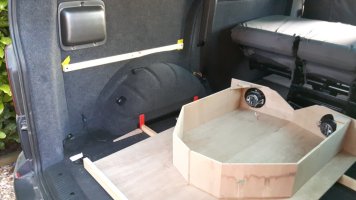

Doing something similar for a customer with LWB. For info, the wheel arch protrudes slightly further into van than D pillar. Been trying to keep inline with D pillar.View attachment 223449

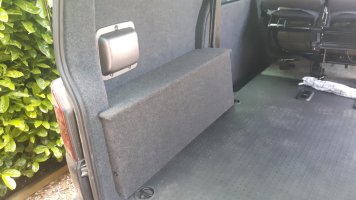

I reckon this could look a lot more inergrated if it covered the wheel arch completely, and maybe incorporated a cubby above the wheel arch.
Obviously this wouldn't work with row 3 seats, but would be good in a kombi. Perhaps the same box on the opposite side, but for storage rather than a sub?

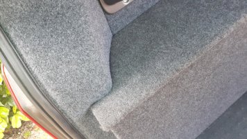

No, wheel arch is slightly wider. Not by much thoughIf the wheel arch wasn't carpeted, would the vertical inward facing board (the one with the speaker hole in it) continue forwards to cover the wheel arch?
In this picture it looks like it might.
great idea I was thinking a similar thing with a hinged lid for some storageView attachment 223449

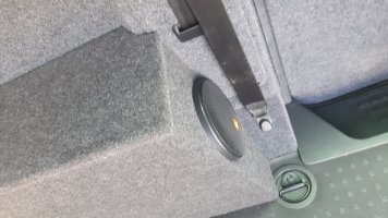

Hi there.@t6blo I'd say he's made it that wide to accommodate the speaker. Looking and where it sits in relation to the floor anchor points compared to the sub enclosure, it could probably sit another 20mm in if it weren't for the forwards facing speakers.
