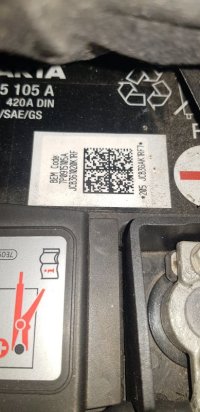

Post a few pics of the battery.
You have a 2016 van.... Is it the original battery?

Here's the battery.

Looks like an original battery to me.?
Could be worth getting it tested at a local place.

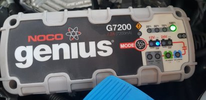

Hmm, I attached the charger, it started 25% flashing red, then went through 50 and 75 ending green at 100%. Then it started back at the 25% flashing red again. Repeats the cycle.
if the battery SOH (State of health) is bad ie - less than 50% then it will show as charged very quickly.
but then die quick.
sounds to me like the battery SOH is bad.
could be time for a new one.
