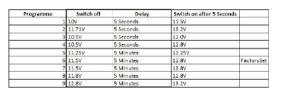

Which precise model of Durite? Pics of your batteries and install always help give context.
It's possible it's not an SCR but a bidirectional VSR, in which case connecting the second solar output wouldn't be needed.
Is it this one?
In which case it is somewhere between a basic SCR and the full bidirectional VSR and triggers itself at these voltages on the van electrics side.
If it's factory default then looks like once the van electrics reach 12.8v for 5 seconds it will connect the 2 batteries, and it will hold them connected until the voltage on the van electrics drops below 11.5v for 5 minutes.

For an interim solution there are a couple of things you could try.
First you could try setting a different profile in the current relay, number 9 looks a lot kinder. But reading the manual the way those are programmed looks... cumbersome, it does use things you already have though.
Second you could fit a Durite Dual VSR. They are still a poor choice compared to full DC-DC but I suspect will be kinder to your batteries than your current relay. Being Dual it senses voltages on both batteries, so as well as connecting when the alternator is charging will also connect when your LB is well charged from solar and divert some of that charge to your starter. It's important to keep in mind that this is still a poor overall solution, as the supplier states the correct solution is a DC-DC charger.
