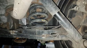

Hi, been lurking for a while but this is my first post.
Had new suspension springs fitted by VW last month. Long story short, it was fairly terrible service but two rear springs had actually broken and it needed doing urgently.
Since then, the ride has been very harsh, especially in the back. I don't know much about suspension but had a look around the van this evening. The back seems to have dropped so I had a look and was surprised at how compacted the rear springs are. I've added a pic - is this normal?
The front suspension measures 41mm from arch to middle of wheel hub. The rear measure 38.5mm, so it's clearly sitting lower at the back. The garage said they'd fitted Sportline springs.
Thing is, my van is a camper with some real weight in the back. Do I need heavy duty springs?
Any advice would be most welcome.
(my van is a 2013 T5 T30 140 4 motion)

Those springs look coil bound. There is no travel for the spring to move up and down .
There should be space between the coils.
Here is a picture of my original spring to show difference. The weight of the van is too heavy for the spring. 20200724_103540.webp

The camper and the all wheel drive are just too much for those springs ( too heavy ) , Idiots put them in who know nothing about suspension clearly /
The spring is collapsed so not fit for purpose and at that height the shocks will be completely compressed and the van is riding on the bump stops .
Need to go to a standard rear spring to balance the rear to the front , I assume the front dropped 40 mm or there abouts ( could be the 4 wd is making the front a bit lower than it should be too )

Presumably they have fitted springs to match the VIN number, therefore factory spec, not taking into account the weight of the conversion, so how would a standard rear spring as you suggest help?
I would guess they have taken a box that says Transporter and think it will fit any transporter , this is the problem a lot of dealers have when fitting coil over kits as well . if they arent fit for purpose they wont work , We have dozens of vans here fitted out by reputable companies and VW dealers and they are all too low as there can never be a "One spring fits all" scenario with transporters , the weight range is too vast .

from the measurements you gave a T 30 standard spring should get us where we need to be , ( Not a lowering spring )
that should give a drop of 40 mm close ?? on the rear , I just hope the front hasn't gone too low as well . The wheel arch gaps need to be the same centre of the wheel to top of the arch front and rear needs to be 410 to 420mm ideally

What happened with my setup last year (pictures) is exactly what @CRS Performance said was the case. I took the van back to VW who put those springs on (by then they looked even more compressed). Service department were horrified when I showed them how compressed the springs were. They did what Steve at CRS recommended and put standard springs on, but with lower rating - this meant the van settled to a good 30-40mm drop once completed. This matched up perfectly with the front which remained on the Eibach lowering springs.
My van is a 4motion T30 with camper gear in - they put standard springs on the rear with 1 yellow stripe. This is what gave me a lowered height.
I’m currently actually raising the van now - to standard and putting some Koni Special Actives on there for a bit of comfort . All change!
