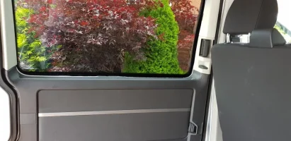

Drilling the holes is a challenge and I probably used 50 clip in the process (kept snapping on me) in the end I used tiger seal and stuck the bugger on, been fine for about 6 months now
yeah i thought similar...n...had the convo with a pal...just rough up the point where the clip plastic mount would be.. and on the mount...bit of emery/wet'n'dry and then bond at that point with a small blob of tiger seal.

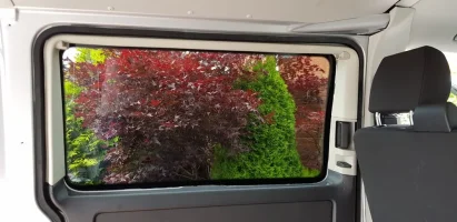

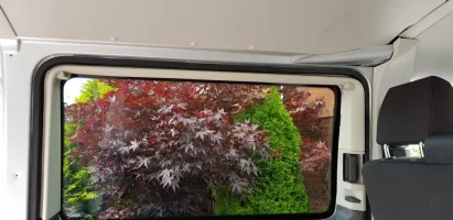

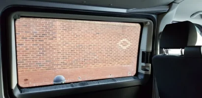

I gave up on the idea, it would be possible to get it to fit the door however where I have installed my windows it seems to foul the door card meaning it would have to be trimmed to fit. not only that the window rubbers would have to be cut out in the corners and over its just not look look i imagined when fitting a door card.

Yes it was just use tiger seal and save yourself the hassle

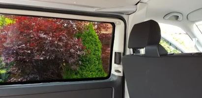

Also if it helps you need to remove the window rubber to get the top part to fit, the clips connect to the inner skin holding the top frame in place, it's a mission but looks great once you have it all together

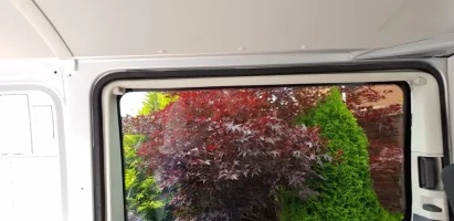

@Pembo could you post some close-up photos of where the trim meets the door / glass, please?
