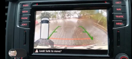

Is their a trick or a reason that in some pictures the OPS of PDC has a grid (spider web) in the segments? I would prefer to get the grid view, at the moment I have a blank silhouette. DM SW level 478

This view mainly depends on PDC module type and the data set used.
If I remember correctly, I think I use Sharan/Alhambra data set on my unit, might need to double check that.
Below is my PDC view(front and rear).
