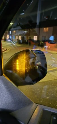

All complete now on my t6.1. Correct datasets obtained from vctool database. Now have to go through the dynamic calibration drive I believe. Part of the self learning of the modules i guess.

Report back, have put 500miles on the van since this retrofit.
Everything seems to be working perfectly.
Scanned the van on Friday with vctools and no faults reported back on these modules. I think the dynamic calibration is probably more than likely done its thing and will continue to do so.
