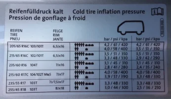

@Wills, I've not got that size, but if it were me I'd run pressures from the bottom of this sticker.
This is on the drivers door of my van. It says to run both a 235/55R17 and a 255/45R18 at the same pressures and a 245/45R19 is there or there abouts. If I get my 19's, I'll be starting with these and then adjusting from there.
I have 255/45/19 and I found that the best compromise of pressures after a lot of testing was 42psi front 46 rear.
That's with a constant weight in the rear of around 500kg with all my kit, and shelving etc.
