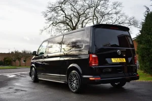

Really liking the look of your van @Tourershine. Can I ask, are the grey graphics on the sills custom made or aftermarket. Quite keen on the Panamericana theme but also like the look of the strip that you have for my silver LWB.I'm running 19's and I have found that sweet spot after great expense.
The secret recipe:
30m Drop
19x8.5 ET45 all round.
Running 104 rated 255/45/19
Giving this as a look if it suits you.
The van never bottoms out, and it never rubs or catches.
I have gone across a field with no issues.
It's planted at speeds, yet very comfortable.
Laymen's terms it's 2 fingers between the tyre and arch at the front, and 3 at the back, giving tolerance for any extra weight in the rear if needed.
(oh and I don't have huge sausage fingers)
