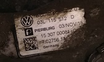

I also have a Euro 5, 180ps, 2016; they do seem to be very reliable as long as it has been built with the RevD EGR cooler.
There’s a tag on top of the EGR cooler (next to the oil filter) at the front of the engine.

The problem with EGR failure is that when you see symptoms, then it’s too late. If it has Rev D it ‘should’ be ok. If it doesn’t, walk away.

Even if it has a Rev D there is no guarantee it had one from new. Then you might have a ticking bomb.
Thanks very much for your feedback. I had thought about asking the garage selling it to send me a photo of the current EGR plate fitted. But as you say if it does happen to be a version "D" (I assume the latest version) that doesn't guarantee that the vehicle was originally fitted with this particular EGR. Does anyone know how to find out from VW what EGR was originally fitted when the vehicle left the factory????? I guess if it is the latest version of EGR has been fitted from new the risk is massively reduced BUT if at some point in the vehicles history it's been changed to the latest version, unless I can find out a date and/or mileage there is a risk that the damage might have already been done? The garage or previous owner are not likely to know or let on if the oil usage is higher than normal.......... VW dealers just won't provide me with any info on the vehicle unless I can prove I own it......GDPR rules & regs. :-(

Hmm... The EGR (cooler) issue before version "D=good" was only on engines (code CFCA) built before approx. mid-2015.
Actually I'd expect to see a totally different engine (code CXEB, also known as 204PS engine) in a 2017 van - the engine code is on configuration label (under dash). Or just post a picture of the engine.

I will contact the seller and ask for a photo of the EGR plate and also the engine code from under label under the dash.
Mine was registered in May 2016, built around Feb 2016 from what I see on component dates. It’s a Rev D EGR unit from build, CFCA unit (180ps)
As @mmi has pointed out it’s probably a 204ps, completely different animal. Check the engine code on the V5 doc’. Hopefully the dealer can read.
