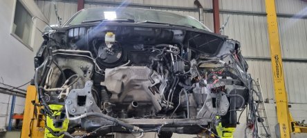

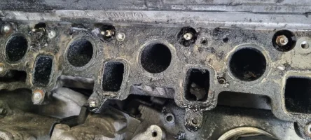

Well, finally, the engine is being fitted and had a look around the old engine before it goes back. Oh my god, I can't believe the amount of damage it has caused. It's buggered the turbo, crank seal bearings, and everything else that oil has come in contact with. But the crazy thing is it drove lovely used no oil or hardly anything so to the unsuspecting person it was OK. Only the occasional puff of smoke when setting off and the odd oil drips made me delve deeper. Can't wait to drive it because if it drove great like that, it should be amazing when done. Just not looking forward to the bill even at mates rates. Here's a picture of the Inlet and my poor van20240709_154356.webp20240709_154408.webp20240709_154447.webp

Well, finally, the engine is being fitted and had a look around the old engine before it goes back. Oh my god, I can't believe the amount of damage it has caused. It's buggered the turbo, crank seal bearings, and everything else that oil has come in contact with. But the crazy thing is it drove lovely used no oil or hardly anything so to the unsuspecting person it was OK. Only the occasional puff of smoke when setting off and the odd oil drips made me delve deeper. Can't wait to drive it because if it drove great like that, it should be amazing when done. Just not looking forward to the bill even at mates rates. Here's a picture of the Inlet and my poor vanView attachment 250047View attachment 250048View attachment 250046
How many miles if you don't mind me asking? With or without egr blanked?
105 without it blanked off. But don't worry after 400 miles, it will be along with a new custom exhaust:cool: oh how I love losing money :cry:

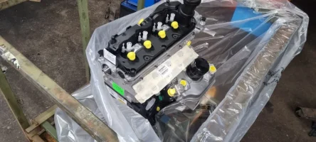

Depending on the compression results I will either fit a Tafmet if its not too bad or if it's low a new VW engine from Darkside or our local specialist and get them to fit the Tafmet while doing it. One advantage of getting a new VW unit is that you get new injectors. Apparently it's still refurb but by VW to original spec.

The vw unit comes complete with egr and glow plugs as well as injectors. But It doesn't come with a water pump or the inlet manifold, and that's on back order indefinitely, apparently. If like mine, you will need a turbo as the oil has worn both shafts beyond repair, which has started to leak as well. I'm hoping to be getting it back tomorrow, which I can't wait. As I've said in my other posts about it, it drove lovely and pulled like a train and used hardly any oil. If you go down the new engine route just blank the egr off after it's run in.
