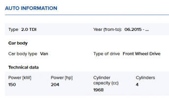

It also seems highly likely that the van isn’t a 180ps, it’s a 204ps with Euro6 engine, as I said before nothing to do with the failing 180ps cylinders.
The engine code will determine this.
