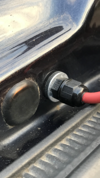

On barn door versions, there are grommets covering the tailgate fixing points.Hold upon the non-poptop+tailgate t6, are we saying there are grommets you can use to pass solar cable inside keeping the roof from having new holes?
ar, ok, never mind plan A it is. Thank you.On barn door versions, there are grommets covering the tailgate fixing points.
Hi ... do you have more pictures when you made it? Also some pictures from insideView attachment 185286
I’ve gone through the existing grommets for the tailgate hinge but then I have barn doors. I use a portable panel when required
niceThese are the only other photos I have, on the inside the cables just run under the headlining and down the b pillar
