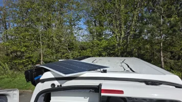

The wind destroyed the solar panel my converters fixed to my roof. They fitted a new one.
This weekend it blew off the van. Luckily whilst I was parking and I was able to rescue it before it caused damage to itself or anything else.
I'm not asking the converters to fix again. Lost faith somewhat.
How are people sticking flexible solar panels on. Are you putting a wind deflector in front of it? I don't want to screw it in, to avoid leaks. 72646.webp

Looks like wrong glue and not enough of it. Mine is on with Sikiflex (the version specifically for sticking stuff to caravans) and there is no way it is coming off!

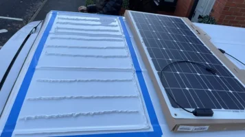

I added a second solar panel to our poptop and I used this stuff. Its the same as the convertor used to stick their panels on with, they recommended it to me. Think I bought 2 tubes but only needed 1 in the end. Not had any problems
Here’s how I did it
