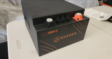

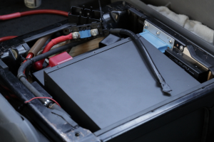

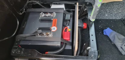

A couple of in-progress install pictures Roamer 230 SB4.... recent installation... This install is in a 2022 T6.1 T30 Highline, it was originally a Hillside conversion.
It is a bit tight and work is needed to relocate some original fitments to make it fit.... but as you can see, it fits and is very tidy. One other thing that I think is neat is that the battery has a built-in isolation switch.... the orange button next to the live terminal. That does away with the need to fit an additional switch!
My installation was completed by Olie at Hythe Auto Electrics.
The last picture shows the original AGM setup...

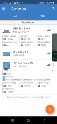

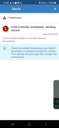

I'm running the Victron Orion XS DC-DC charger on both vans now.. (with the 230ah seat base battery)
I normally set the current limiter to 30A to keep the temps down.
Last week though we had a long camping trip and run the battery flat, well down to 6%. And had a 2.5hr drive to the next location.
So I tweeked the XS to a 50A setting... Ironically it was the hottest day of the year... And we have the over temp alarm from the xs.
No issues as it just rolled back the power to drop the temps....
But something to consider when pushing chargers hard.
It's always best to not run chargers hard at 100% for long times ... And much better to run them 50-70% rated power.

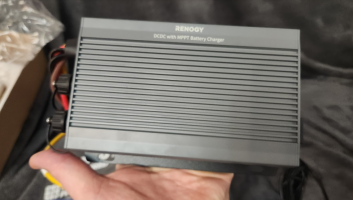

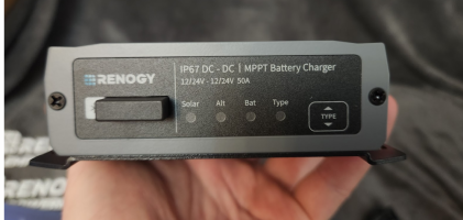

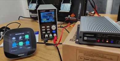

Has anybody fitted a Renology 50amp dc/dc charger next to one of these? I had intended to order one but figured I’d wait till I’d got the battery. Now not sure it’ll fit and even if it does sounds like it will run hot as hell under there crammed down the side of the battery. There is space down both sides as I’ve kept it quite simple and neat but even still can’t see it fitting?
the newer IP67 version is small enough to fit, and has built in BT + App.

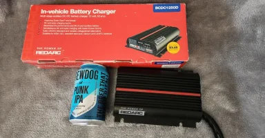

or you can buy my REDARC BCDC1250D

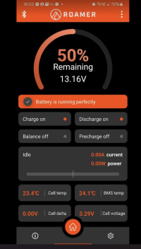

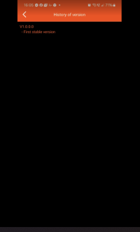

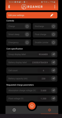

Also... the iOS app is FINALLY out. This has been a massive headache, it took 8 attempts to get it approved. All sorted now though. Links below
iPhone
Android
Positive reviews on App Store very welcome Please bear in mind this is just a first version of the app so if you spot issues please let us know privately. We've got a google form for feedback linked below. Plan is to roll up any suggestions and bug fixes in a v1.1 in about 6-8 weeks
