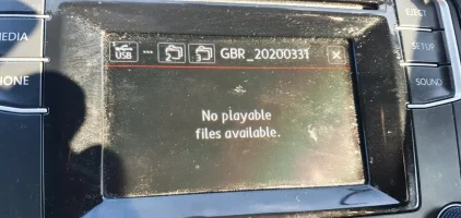

Yeah, trying with the usb port and an android phone this time. I can find the logo file on my phone searching through the head unit, ie GBR_2020.... But it seems to only recognise music files. Wont entertain the .png file format.
