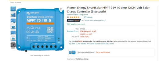

I think I understand that a panel cannot be plugged directly into the leisure battery but has to have a controller in between to stop the LB being overcharged, is that the way it works?
You're a star @Dellmassive, thank you so much.
So maybe I am not as much of a dunce as I thought and Portable Panel ➜ Victron Controller ➜ Built-in Leisure Battery gives me top up without the risk of damaging anything?

yes, - follow the connection instructions,
fuse the battery connection,
use suitable wire,
set the controller to the correct battery type, ie Lithium, AGM etc.
watch the free sun power charge your battery via the Victron APP.
happy sunny days. . . .
example battery link cable,
get this, then cut off the socket.
use the ring terminals to battery/busbar/fuse box. - and connect the cut end to the solar MPPT battery terminals.
this 10A fused cable is good for the 100W - so is fine for that 80W panel.
it looks like that panel uses MC4 connectors,
so you will need a patch cable like this. . . so that you can attach the panel to the solar controller. .

that's basically the bits you need to make it plug and play.
blue - solar mppt controller
green - mc4 link cable
red - battery fused link cable
Some portable panels come with a controller, which removes one of your connection challenges.
The controller is unlikely to be as good as the Victron, but it will work.
