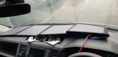

i used this 50w one, , and plugged into dash 12v socket.
and just about managed this 100w panel, . . .
heres the other stuff . . . .

Got an Ecoworthy fold up 100w solar panel. Fits on dash when parked - see pic above posted by DellMassive - that is the one.
In full sun, when solar panel is on dash it supplies about 20-30 watts which is more than I was expecting as cells not angled exactly and are a bit boss-eyed etc.
They were set up set up on the dash at about 9am and disconnected at 4pm - van in shade till about 11am. Sunny till 2.30pm then a bit hazy/cloudy but still giving 24w.
Given that it was behind the filtered by the windscreen and only had direct sunlight between 11am and 2.30pm, managed to harvest about 60Wh over 5 hours of mostly hazy sunshine.
My 100w jackery folder on the dashboard in full sun in the south of France used to produce around 30-40w. Angle of attack was fine, but as you say, the windscreen filter must filter around 50%.....
