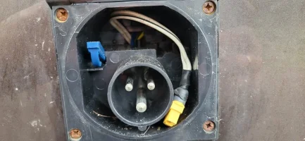

I have a 200W cheapo panel from Ebay - https://www.ebay.co.uk/itm/334791196734 Then put an XT60 connected through the 240V socket flap to the solar and straight to the leisure battery charger terminal (effectively to the battery terminals direct). Works a treat! Never run out of juice on a camping trip yet. Longish cable on the solar panel so it can be positioned away from the van if that is better solar.
BTW - yes I know the screws a rusty - on my list to replace with stainless this summer.
