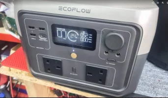

loving the EF R 2 MAX. . .
same top quality as all the EcoFlow units.
same APP aswell.
still running it through its paces. . . so far its run everything.

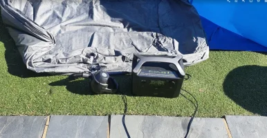

As for the 12v Pump . . . . . . . . .
as for the pumps. . . .
i have this OutdoorMaster 20PSI SUP pump that i use for our air tents.
says a 12A fuse, . . . . . and 110w
so far its been fine with all the 12v power packs. . . . at least up to 8PSI anyway.
the only time it cut out a battery pack was when trying to add air to a tent that was already at around 5psi. . .
as this is a twin pump, high volume to 1psi, then swapps to a High Pressure pump from 1pSI.
when connecting the pump to the tent it read 5psi . . but wouldnt start (tripped out the power pack)
the easy fix was to disconnect the pump from the tent and start it running . . . then plug in the air pipe to the tent. . . this was enough to keep the pump running up to at least 8psi without cutting out.

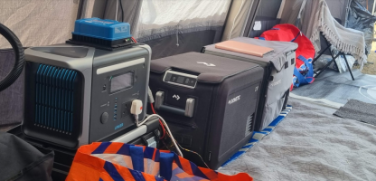

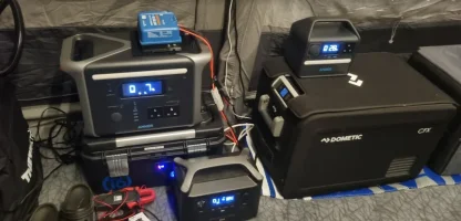

its also important to note that the Dometic fridges have a separate 240vac input, and a separate 12vdc input.
some of the Chinese units have a 12vdc input - but then just supply a dc power brick that plugs into the mains. . . so an external power supply possibly even 14.5v ( which is good).
this is important as in my testing the units were happier with the 240v mains as running off the 12vdc side the voltage was already say 12.3v . . . then with volt drop over the cable the fridge may struggle with lower voltage, so draws more current. the fridge may see 11v at the compressor . . . . in which case its better to run from a small pure sine wave inverter.
thats how i run my fridges . .
battery box with 12v out.

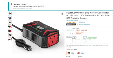

into one of these small inverters. . .

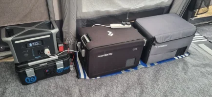

In some.of the pics above you will see me using the 240v from the power packs into a extension lead.... Then onto the fridges and lighting etc.

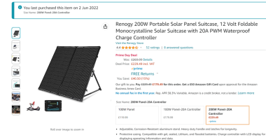

ie - a 200w solar suitcase like this one. (then panel VOC spec needs to be below the power pack solar input spec)
Specifications​
  • Max Power at STC: 200W
  • Open-Circuit Voltage: 24.3V
  • Short Circuit Current: 10.42A
  • Optimum Operating Voltage: 20.4V
  • Optimum Operating Current: 9.82A
  • Dimension: 1062x530x70 mm
  • Weight: 15.6 kg
