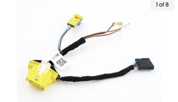

Really appreciate everyone’s input - thank you. Decided to go for MFSW without CC and CC on the stalks.
The fun begins this weekend. This is what I’ve picked up so far:
Polo Steering wheel
Airbag harness from from a Golf
Retrofit cable kit
