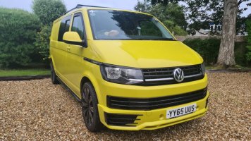

The van I ended up buying cost me £14k....it seemed a good deal but you be the judge??
2016 T32 LWB 102bhp Startline...was on a personal plate at time of pictures
Grape yellow
106k Miles
Full History and recent cambelt
AC
Split charger for leisure battery into a weird box panel thing for controls
Carpeted over ply lining
Smelled very strongly of lemon
So the van itself seems solid, it came with 20inch rims that rub the arches and needed a good clean.
I am a little confused regarding the spec, as it appears to be a startline but has a body coloured bumper and sportline front bumper. The guy I had bought it off didn't seem the sort to modify so a bit weird. Otherwise It has the start/stop engine, and DAB radio....that's about it!

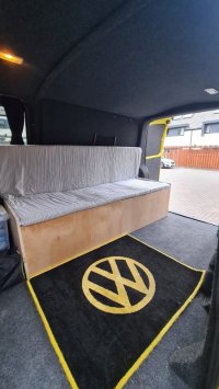

- Bought a DIY pull out bed. But it isnt the best. £240. Currently using a sofabed mattress which is doing the job.
- Removed a kitchen cabinet that came with the van. It was incredibly heavy!

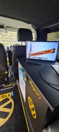

- Bought a 12V Television and cheap magnetic aerial. Works great.

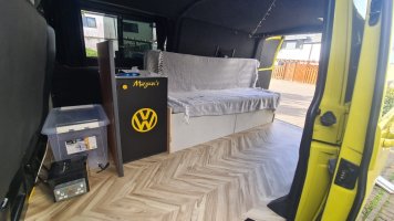

Also ordered a lino cut floor as we have a Labrador and i often put muddy bikes in the van. Much better! Easier to clean and fairly easy to fit. Just required some gentle trimming with a Stanley knife.

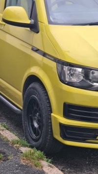

I have been wanting to get rid of the giant wheels and lift the van. I am a huge fan of the swamper look. They are my dream camping/go anywhere vehicle. Wish I had a 4 Motion but it is what it is!
After a few pints on a friday I found a PCD 25mm lift kit for T6 on Ebay for 80 pounds. As I dont intend on heavy offroading then these are fine for me. I may switch to Koni shocks in the future.
I managed to sell my wheels locally, and bought a set of Tomahawk Katos with Yokohoma Geolander GO15 tyres (245/65/17) from Rogue Alloys. Great company and excellent customer service. The wheels are literally bolt on. No spigots needed.
The van is in the garage right now having the lift kit fitted, alignment and tracking done, and the new turbo pipe sorted.
I will get up to date pictures tonight, but heres some with the Kato alloys fitted on standard suspension.
Final update until the bed comes...lift kit and rogue alloys fitted and sorted!
Happy with the look and glad I only went for 25mm in lift. I decided to go for spacers as I wont be driving off-road often. Mainly tracks and trails. Therefore I couldn't warrant spending £££ on a full setup.
Ride is similar to before. With the combination of bigger tires/tread and spacers there is definitely more noise in the van (I'm quite sensitive to noise and vibrations so others may not sense it as much). So far so good! Shall report back on long term usage.

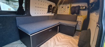

When I had my electrics overhauled the company who did the refit informed me that my van had undergone a cheap and cheerful conversion. The electrics were a fairly dodgy DIY job (now rectified) and the lining had been done poorly.
The inside of the van is carpet lined. With the ply panels being lined and then put back in place. There is no insulation in the gaps and the boarding is only screwed down in a few places causing them to sag when there's stuff hung on them.
My plan is as follows:
- Remove ply boarding
- Cut away carpeting behind the boarding and line the van with Dodo Thermo Liner
-Replace the old boarding with stitches and steel panels (in theory they will work well for my desired vibe
Any thoughts? I'll report on the Stitches and Steel panels as I have seen mixed views.
Well they are done. It was quite a fight.
S+S Panel Retrofit Steps:
- Removed old ply panels by unscrewing.
- Cut away carpet to expose bare metal walls
- Add Dodo Thermo liner and fleece wool to walls
- Cut out holes from carpet on metal to expose the factory holes
- The push clips are quite fussy, the holes need to be completely clear for them to go in so it is quite fiddly
- Panels with no carpet on them were a doddle
- The CNC cut of the S+S panels is good, they match up to the holes really well
- 2 holes needed drilling to move the hole in line slightly
S+S Panels:
I read some comments on poor quality of these. The edges are unfinished, and they are a little rough, but they are designed from a utility perspective and they do it perfectly. They seem tough and personally i much prefer them over having hairy walls. It definitely makes the van feel more professionally done. The addition of insulation behind the panels has been a huge shock as the van is so much quieter! I really like the crosses on the panels as you can hang bungees all over or use "S" hooks. I used two methods for mounting the bungees...
- Cutting a piece and putting a thumb knot in each end, then wedging the knot behind the cross cut outs
- Feeding the elastic behind the panel and connecting the elastic together with a reef knot, then scooting it round so the knot is at the back of the panel
The latter technique seems to work best, using thumb knots just seems to pull the elastic out.
All in all, im really pleased with the panels! They work really well and are a much more contemporary alternative for an adventure van setup.
