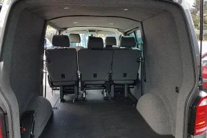

Does anyone have the part numbers for the whole c pillar seat belt assembly? Even the panels to cover the retention roll would be great.
I’m looking at doing this could you please tell me what brackets I need for underneath?
Also could someone measure the width of the middle seat and the width of the gap with the seat removed?
Thanks I want to see how much of a motorcycle would fit between
From drivers side interior panel (no door) to edge of double seat 43”. From edge of double seat to sliding door (passenger side) 24”.

Cheers but I need to know the width of the centre seat or the gap left with seat removed on a 2nd row single seat set up
There’s brackets that fit underneath chassis side for the seats. They bridge across the chassis members!
Arh - you’re after the triple / individual shuttle seats?? Re brackets you’ll need more of the double ones and less of the singles!
For the offside seatbelt measurement it seems to vary depending on whether you have a sliding door and SWB/LWB, for future reference:
SWB single sliding door - 64.5cm
LWB dual sliding door- 68.5cm

This Seat fitting Lark is not a 5min Job ✌
I’m a bit further ahead but not got anymore pics at present ✌
