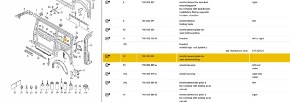

Hi Elliot,
This thread has been so helpful on my kombi seat install! Finished it up at the weekend and have came to install the seat belts.
Can you tell me if your seat belt brackets had this angle on? Reason being is that I’ve been told I’ve ordered the wrong ones and that they are meant to be flat?
@SButcher I doubt Elliot can help, he hasn't been on in a while!
Anyway, that bracket doesnt look like the C pillar ones I used!
I used part no 7H0 810 563
Looks like you ordered 7H0 810 583 rather than 7H0 810 563......or the VW parts man did?
