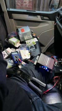

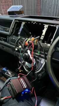

Ok so a bit of an update. Stripped away the old head unit wiring and a lot of the previous auto electricians work, he wired the revering camera, tv and rear lights in.
So I took the iso block and took a feed from the ignition live. I split this in to two 12 sockets. 1 was plugged in to a cheap 12v amp which had amazing Amazon reviews, the other I plugged in a 4 way usb plug. I plugged this in to the iPad and a dash usb socket that used to get its feed from the head unit.
I used some hot glue to hold the cables and some spark tape where needed.
