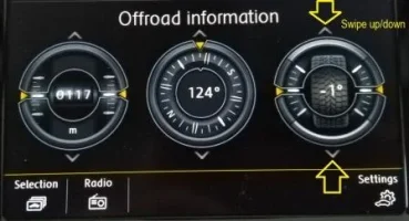

only issue is, I can’t get back into any of these screens unless I activate/deactivate hybrid adaption channel. Even if I select OFF-ROAD from menu, there’s no menu icon at the bottom LHS
Indeed, before the breakthrough startup screen after IGN ON was "Power flow" (even though Hybrid not active) but had to go "Settings" and Back to get the Offroad display. There was no way to get back on Offroad display after leaving except IGN OFF/ON.
Interesting detail is that the three dials could be scrolled up/down to change their content.
EDIT - added a picture to clarify. Note: interestingly this functionality is not available in "stable" Offroad display (see my post further down).
The settings available then were:
But time and date was empty:
Also got menu showing units - but that didn't work - was just "read-only".
The interesting one was the menu with dials to change volume and tone of front/back parking sensors individually. All the dials actually worked and changed the tones and volumes :confused: - so how to make that work...again...
So all these features/pecualirities were there before the final breakthrough! None of them any more - at least under offroad settings.

However, the oil temp doesn't show on the dial for me. The "60100 Vehicle Interface" code in my unit is neither installed nor supported (---> <Link> ). Though interestingly the steering angle is active in the view, the data for the other two certainly could be "more local" just in the Infotainment unit itself.

Just been out to mine and it's the same. But, my engine is cold and if you look at the oil temp on the MFD that is reading --- too. So my guess is that you have to wait for the oil temp to reach a certain threshold before it registers a reading. I have to nip out later so I'll report back with a warm engine.

Correct, IC reads oil temperature over 50°C only so I would expect infotainment to do the same.;)

I am going to propose my full theory later on but so far I am convinced that you need revision D or higher to be able to have OFFROAD menu entry in the main menu and then oil temperature comes with it by default.:)
