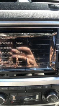

Hi all, new member here so please go easy!
I'm using a revision E version, P/n 5C0 035 680 E, SW 0359, HW H31.
Installed codes:
40100
9400008
70200
50000
30000
60300
60800
60900
60100
60200
70400
All SWaP codes show a different VIN to mine, as the units a retrofit into a PQ35 vehicle :whistle:
Following the information here, I've got the off road menu activated and working (apart from the level gauage) however:
To access it I have to do the three button press (voice, menu and nav)
When I do this, I get this screen (fuel range doesn't registor on the screen)
If I do the Hybrid activation I get the Hybrid menu tile but this seems to cancel out the off road menu, no options show at all, I can't get to Offroad, only Powertrain and and accosiated screen for power regeneration (obviously both non-functional).
From messing around activating the TMC before, I actually had to leave the car for a while (or have it running anyway) before the feature activated, or at least thats how it seemed. Futher messing around with fuction options enabled a host of menus in the settings screen of this level, central locking, driver assistance etc. Everytime I tried to access them I got a message saying "not available".
I don't have a "5F"gateway yet, I put it off as I can still access the radio using VCDS (full genuine before anyone asks) but it just doesn't show in the installation list.
Thought I'd share my expieriance as its not a part number I'd seen on here, and also the TBP hadn't worked for anyone else :)

Update:
Had the performance monitor activated on my unit, genuine activation just wasn't by VW :whistle:
This has added a host of new menus to the unit, still accesed via the TBP.
Screenshots and update to follow, but does anyone know where the unit gets its readings for the steering angle etc from? Is it from the CANBUS gateway?

As promised, an update:
Performance monitor activated, vehicle status already showing as "active" in the lists as per previous posts. However, the gauges all display 0 readings, as does the steering angle on the off road mode.
New menu items, then click into each spoiler to see under that menu
49949030746_d875b9c599_c.webp49948569943_4b6020c4f4_c.webp49949077071_3f793158a7_c.webp49949377367_cf3d99dd03_c.webp
49948772908_0066a2f20b_c.webp49949280341_c5dc78ca4f_c.webp49949316226_e2293522df_c.webp
I've also posted an admap of the radio for anyone whos interested!
Finally, I'm trying to work out where the radio gets thedriving data from, if its the gateway or the clocks. I think its the clocks, so I'm working on finding a set of 3D clocks to pair with it and hopefuly get everything working.
