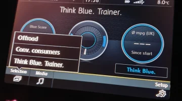

1. Change your infotainment adaptation channel
ENG122227-ENG117606-Car_Function_Adaptations_Gen2-menu_display_hybrid to activated
2. Check if you have new entry in the main menu called "HYBRID".
3. If yes, click it and enter your new menu entry(as our vehicles are not hybrids there is nothing really useful)
4. While you are still in that menu change the same adaptation channel
ENG122227-ENG117606-Car_Function_Adaptations_Gen2-menu_display_hybrid to not activated
Now you should see something like below
5. Press on the screen bottom RHS car/gear icon and enter configuration menu(just for the purpose of entering that sub menu, you will adjust things later on;))
6. Exit configuration by pressing top RHS twisted arrow icon once.
7. Click bottom LHS Selection icon and see what shows up there.
8. Do whatever you like, check everything, enter/access/modify/adjust :thumbsup:

1. Change your infotainment adaptation channel ENG122227-ENG117606-Car_Function_Adaptations_Gen2-menu_display_hybrid to activated - CHECK.
2. Check if you have new entry in the main menu called "HYBRID". - CHECK, Yes I have.
3. If yes, click it and enter your new menu entry(as our vehicles are not hybrids there is nothing really useful) - CHECK.
4. While you are still in that menu change the same adaptation channel ENG122227-ENG117606-Car_Function_Adaptations_Gen2-menu_display_hybrid to not activated - CHECK.
Now you should see something like below - Yes but no, actually no chance, still Hybrid thing - Power flow.
5. Press on the screen bottom RHS car/gear icon and enter configuration menu(just for the purpose of entering that sub menu, you will adjust things later on;)) - CHECK.
6. Exit configuration by pressing top RHS twisted arrow icon once. - CHECK.
7. Click bottom LHS Selection icon and see what shows up there. - CHECK, selection box is empty (not even hidden items in there). Interestingly the Refuel range (with correct value) appeared, so there definitely is some intercommunication onboard.
No progress from here. :(
All regular things seem to work just fine. However, the unit won't turn off. Needs "long press reset". All "changes" are gone - as expected.
2.
6.
