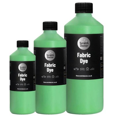

I might do for the plastics. It's this stuff...
Just wipes on. There's a bloke on YouTube used it on his T5. Caravelle has fabric on the a,b & c pillars, need to work on rear headliner. That will be fun!
Scrap my last - if anybody does this I would advise against wiping it on. I ended up with streaks on the headliner. I spoke to the company I bought it from and they said to get an old spray bottle and spray the dye on. They even sent me another bottle to try it with. Anyway, the result is much better and when I eventually pluck up the courage to do the rear headliner I'll be spraying from the outset. Here's a photo, need to get some buzzweld for the plastics and it'll be complete in the cab at least.
