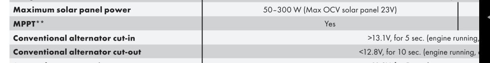

is the model 250se that you recommend?
I would like to add 240w in solar panels. Will that model support that?
From the manual from the UK spec CTEK
You should double check that's the same for the model in your market.
So yes 240w is fine so long as the Open Circuit Voltage (OCV) is 23v or less, check that in the specifications of the panels you are considering.
I was thinking of califaktur, as they look sick:
Looking at the specs, it says: Open Circuit Voltage Voc: 23.4V
Is this ok? or 0.4V makes a difference?
