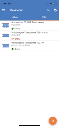

My work van turned up in October. That build is done and I'm happy with the result:
Post #97.
I may do a build thread for when the "family van" is kitted out. @BognorMotors assures me it's now built and on its way! Whoop!
So not long until the "Volkswagon Transporter T30" becomes "online" too:

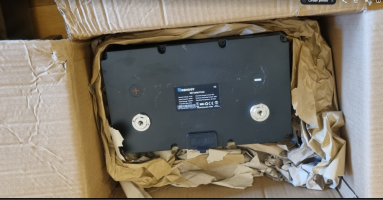

new battery is in . . .
Nabbed one on ebay RENOGY 100Ah for £280
Renogy 12V 100Ah SMART LiFePO4 Lithium Iron Battery RBT100LFP12S

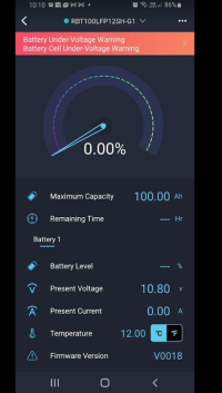

its arrived dead flat with 0% SoC.

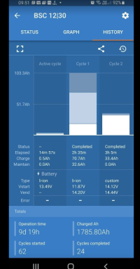

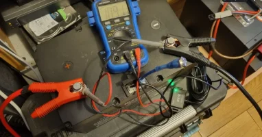

plugging in the victron charger, BT-2 dongle and the sleep button . . . its come to life.
BMS warnings from the start . .
after a few mins . . .
so far so good . . .
ill update as the testing continues.,
note:
i had to get my own bolts . . .
M8 x 1.0 Fine Pitch 16/20mm
a few restarts and were are there.
full charged and BMS reset to 100% SOC.
