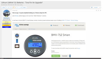

But what about my DC-DC charger? - how do i stop that from charging my batterys when cold? . . . . Well the BMV has a latching relay on the back of the display.
This can be set to do many things, but in out case we are setting it to be a LTD (this is a separate setting/adjustment to the mppt and works independently).
We set the alarm relay to open at below 4degC and to close again above 6degC (you can set whatever limits) we can now use this relay to interrupt the turn on signal for our DC-DC charger.
in our case its a Redarc BCDC charger that requires a ignition/run feed to start working. . . . . so if its to cold the BMV will keep the BCDC off untill the temp rises (by disabling the ignition feed to the dc-dc). (DC-DC LTD Done!)

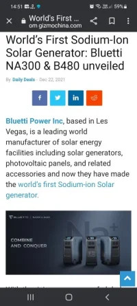

Sodium-Ion cells hit the market.
The next version of Lithium?
By Bluetti.
Hello Dellmassive, if I am burden you on it... I have a similar setup...smart712 bmv, two victron smartmppts, 200ah lifepo battleborns) smart sense tempsensor and Redarc bcdc40d. well the mppt are set to shut off at 40degrees and they work great... but the Redarc is a different story. the redarc is setup for lithium and I have the blue wire not connected, im no longer using the built in solar mppt either...My question is how exactly did you connect the redarc to your BMV712? If I understand correctly you basically connected a trigger wire to the BMV relay...but which wire is that? And how to plug into the relay? thanks for your time I know the thread is old hopefully your still around
I used the BMV712 low temp alarm mode to trigger a high power relay to disconnect the starter battery feed to the DC-DC charger. ( Or disconnect the leisure battery output side )
I'll update with a schematics later.....

Now the cleaver bit, you create a VE-Direct bluetooth network via the Victron app, this enables the BMV to report the battery bank voltage and temp to the MPPT wireless via bluetooth..
The solar MPPT has its own setting in the lithium profile that you can now set the LTD point . . . say 5degC, so at that point the MPPT will stop charging the battery. (Solar MPPT LTD done!)
No external cheap temp PCB`s, no external SCR or contractors, nothing get disconnected and no messing about . . . . . . . just a BMV (with temp), MTTP, DCDC
Now, as for a LBD, thats easy, just buy a victron battery protect unit and set it to 11.5v disconnect then wire between the loads and +v battery terminal - but ill show that a different day.
More detailed look into things below . . . . . . .
