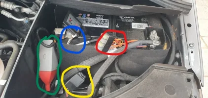

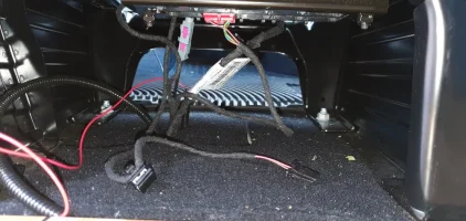

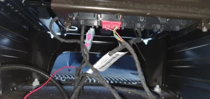

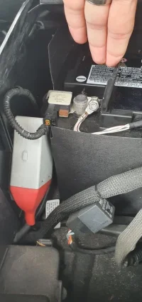

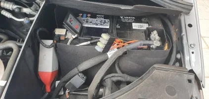

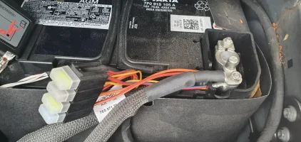

@Dellmassive , can I just check something out with you….?
Renogy battery arrived, Renogy DC-DC arrived and I’ve got the wiring kit (DC-DC charger Wiring kit XL. | travelvolts) and 12 way fuse box (12 way fuse box with negative rail. | travelvolts) on the way from Martyn at Travelvolts tomorrow.
So my first task is to get the ‘wiring kit’ from the starter batter through to the cab and under the driver seat and then worry about everything after that…
I’m following your ‘How I done it’ thread and as you suggested Martyn’s guide for Ctek/RedArc to get the cable through and to identify an ignition live etc. (https://docs.wixstatic.com/ugd/d959f6_3ed319f968954720a73c38807b437278.pdf)
I had a look under the bonnet this afternoon to start to get familiar with stuff and then recalled something the dealer told me when we bought the van. He mentioned there was some extra on the vehicle spec sheet related to the electrics so just gave them a call to clarify…the sales guy couldn’t tell me much more other than “it has an electrical interface for external use with a terminal block under the drivers seat – item code IS1”… he mentioned that some people use it to power additional devices inside the cab…
Does that mean anything to you? Have attached a couple of pics from the battery compartment and the cables visible under the driver’s seat (ignore the red wires in in the trunking, they are for a set of spotlights that the pop-top roof fitter ran to there for me).
Just wondering if that might save me some work, there’s certainly no heavy duty cable under there that would be sufficient to connect starter to aux battery but not sure what I’m looking at currently already connected to the starter battery and under the seat…?
1st of all . . . whats those 4x fuses for next to the starter battery for?
2nd`ly . . . ;. you need to move those "white cables" OFF the battery negative post to a proper ground point. (looks like 4x negs for the 4x fuses in point#1)
3rd . . . there doesn't look to be any 100/80A supply cables from the main battery fuse box (under the seat) . . . so you need to run in new cables.
4th . . . what the relay for next to the starter battery and that red/grey thing?
